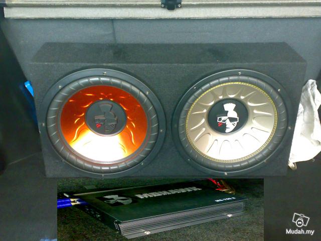

box woofer 12'x2 sy ni sua lar kecik.. nda ada lubang pula tuE.... apa kelebihan ada lubang ngan nda ada lubang? sama box besar ni ok ka?
Tong woofer kecik dan xda lubang angin. - Page 2 Lol10
ni gmbr box sy.(haha. baru bli d mudah.my)

kalau box kecil dan tak ada lubang (sealed) ne kebanyakkan main SQ dan bass dia tepat... kalau ada lubang (ported) ne main SPL, kalau ngam setting dan barang, ne memang kuat... saya punya tong pun dulu sealed... begegar juga la hehehe...
bukan sealed = SQ dan ported = SPL. Org pakai ported pun buli main SQ. Ported punya low end extension lagi bagus dari sealed kalau mau banding lets say 1 cu. ft. sealed sama ported.
Kenapa org selalu cakap ported ni utk spl pasal, itu port macam 2nd cone area lepas tu efficiency woofer akan tambah. Kalau port area sama dgn cone are (sd) dalam theory SPL akan increase 3Db.
aku cakap begitu sebab itu kebanyakan org dlm forum ne ckp, and org yng post ne kira baru lagi so no hastle for much details, pasal ne brg experiment, kalau dia pandai bikin, sealed tong ke 1.5Cu.ft or more for each woofer... and port tidak dapat d anggap 2nd cone area sebab dia tiada respond. the port menentukan tuning box, how long and wide the port have to be depending on the tuning desire. ne semua pakai calculation and varies from woofer to woofer...

beautifulcreature wrote:
port ni bagi i utk tune box jer..besa kalu men SQ, port tune di set rendah n kalu men SPL, box tune selalu di kasi tinggi..box size n tune pula harus disesuaikan ngan subs yg diguna..
yg second cone tue menan passive radiator tu kali..spl naik sikit je tue..x akan sampai 3 pun..
yup, i agree, cone area is for subwoofer, that's why it's called area, not coneport area hehehe and for SPL, the lower the frequency the better, tapi depends la apa jenama brg diorg pakai....
