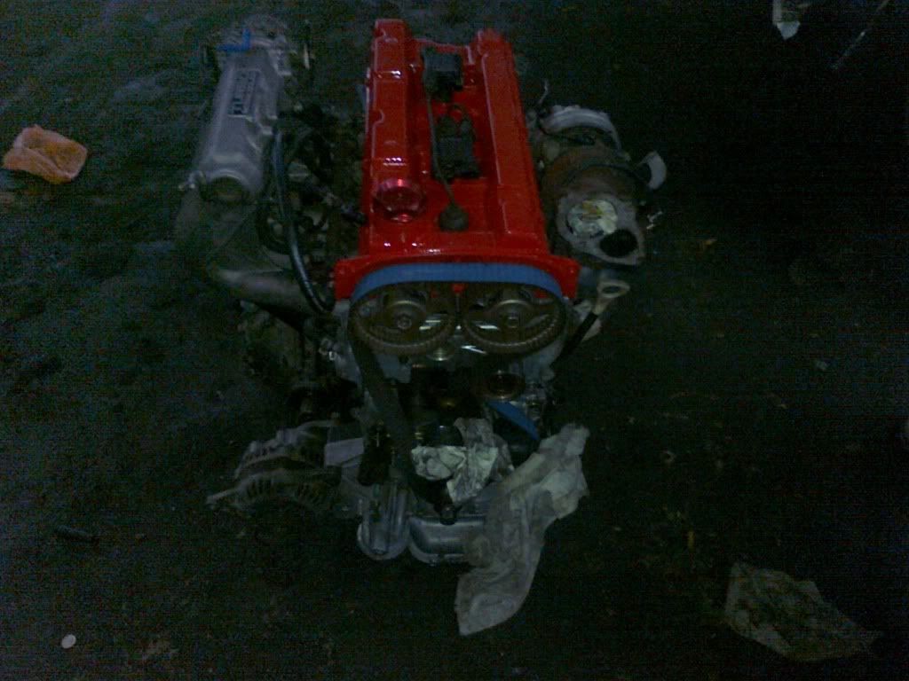

    Post on 23/10/2011, 3:23 am by apex362
    [img][/img]
    gsr ck+head mivec
