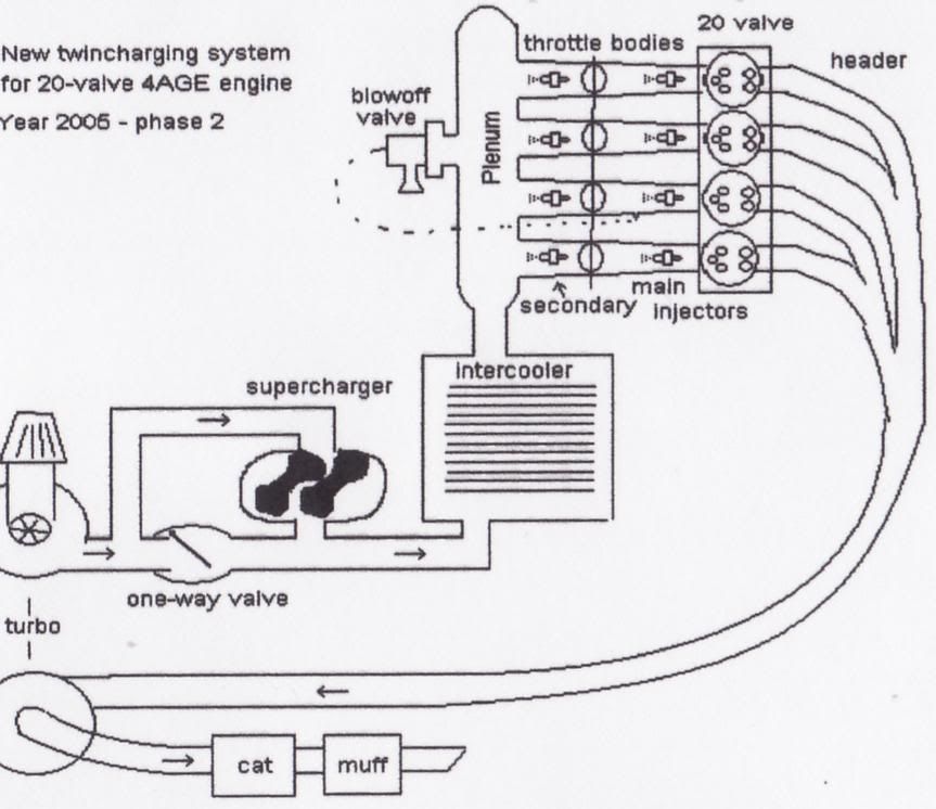

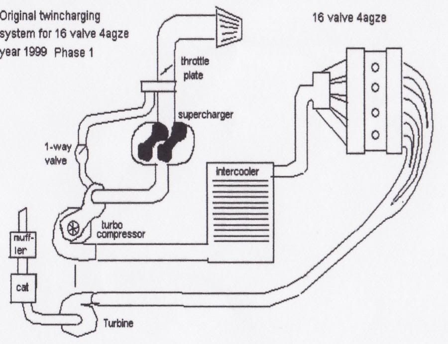

hihi sy pun bukan pro baca2 sj..ada kawan pakai 4ag supecas mula2 plan mo wat twincharge tp considering complexity+cost+susa mo diagnose if anything goes wrong he opted foe bb turbo..tp samp skg blum jalan lg projek dia xda $$ hehe.. ni saki baki fail dia
Turbo vs. Supercharger Twinchrg
supecas + turbo
Turbo vs. Supercharger Twinchrg2
supecas + turbo + 20 valve head swap
Turbo vs. Supercharger Twinchrg3
individual throttle body remove use single throttle body
(xigt dapat dari mana so xle bg credit..will look up into this l8r..)
supecas masuk boost n tutup 1 way valve tu..utk high boost turbo spool n buka 1 way valve..fueling mesti cukup n poin d mana turbo kick in mesti ngam klu nda jadi dead spot jak dlm dyno
satu yg bagus dia supecas ble letak suis (clutch belting dia electronic actuated so bleh bypass suis on-off) so klu bawa santai off kan utk pjimatan minyak..still with racing cam, low comp piston, metal gasket etc..don expect the fc to be the same as na car.. cheers minum dulu

Kalau pasang 2nd set injector mcm dlm image 2 & 3 tu, lagi hebat dari setup bakakuk, so... adakah dia suda terfikir mcmana mau setup itu one-way valve, pernah jg dengar ada org try buat nie di penampang dulu, 4AG pakai twincharger, tapi so far blum ada result yg memberangsangkan. Mungkin mau pakai standalone/aftermarket ECU utk cover ignition timing & AFR. Suis supercharger kena manual ka, best jg kalau bleh on/off itu suis, kena relay on turbocharger la kalau suda off suis, tapi.... komfom kreta nie mmg tidak sesuai dipakai utk daily use suda, in my oppinionlar...

found the website yipee!!
cekout this cool project!!
http://www.geocities.com/MotorCity/Lane/1231/20-valve.html
http://www.geocities.com/MotorCity/Lane/1231/index.html
credits goes to twincharger@hotmail.com
1. 2nd set injector tu utk elakan fuel starvation time high boost..injector standard 4agze 365cc jak..gud for up to 14psi boost..higher than that afr can go too lean n detonate the engine.
2. ecu dlm projek mamat ni sgtlah menarik sbb ecu dia megasquirt DIY (betul DIY tak tipu..) yg lagi menariknya sudala DIY, bole cntrl injector, boost, spark, supecas on-off, knock sensor, ignition timing, vvt, ignition retard per pound of boost, n mcm2 lglah..software utk tuning pon dibagi free!! pehh.. so sepa2 yg terer bab2 letrik n letronik ni tgk2 lah link ni..
http://www.msefi.com/index.php
supaya nanti bolela kami yg nda terer ni minta tolong buatkan kan hihihi
3. Suis supecas xpyh tambah relay dia mmg ada sedia suda..cek pinout comp box 4agze (SMC) utk supercharger relay, bypass wayar dia n letak suis.
4agze ecu pinouts:
http://www.geocities.com/MotorCity/Lane/1231/pinouts3.html
klu pakai dashboard ae92 yg ada indicator supecas tu, wlupun suis off n supecas nda hidup, indicator dia masih mnyala klu tekan minyak. this is because ecu use different pins (TIL) to control the indicator. no need to worry bout afr mixture going too rich klu pki suis sbb jumlah minyak dikawal oleh boost/vaccum sensor di intake.
4. the dude above uses his car often if not daily..not a problem for 5 years until the 1 way valve give up n went into his turbo..those valve werent really meant for this kind of application in the 1st place..so in term of reliability, i don think there'll be much issue as long as u know whatcha doin..
somebody somewhere post 'mildly tune' twincharged engine punya dyno graph (will look into this l8r)..smooth curve from 1k rev-redline sejibik macam enjin v8 na..more reason to be tempted i guess hehehe Wink
